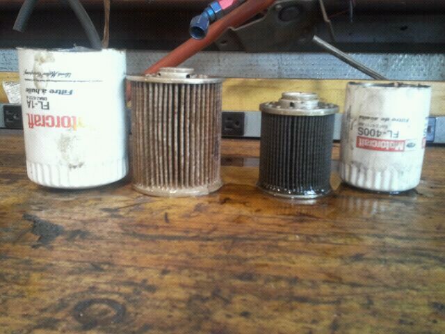

So after replying this morning, I did this when we got slow...

And just something else to keep in mind.. though I fully and completely realize I'm no engineer/ engine builder by any means.. But all the LSX based stuff is still running a filter even smaller than the FL400S.. just something to think about..

Filter size would dictate how often you should change it.
It would also change the flow rate of the filter. The more surface area, the smaller possible micron filtering and keep flow rate up. Smaller filter can't flow the same and filter the same too or if it does, it would have to be changed more often.
Thats my take on it and that isn't saying that the FL-1A flows or filters any better! It might not be superior right off the bat.
